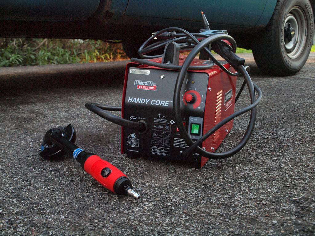

So, I dragged out the welder (it is a Lincoln flux core wire feed arc welder, 110VAC) and my new Eastwood air angle grinder that I bought on eBay. (It seems to work really nice. I originally bought it to cut the fenders off of my trailer, but it worked well with a grinding wheel to try and clean up the rusted pipe as well.) So, I tried to clean off as much rust as I could to get a good contact to weld to. The only problem is, I found out that I can't weld worth a $%&#!!! Here are the before and after pics of what I'm working on:
The welder and my cutoff tool:​

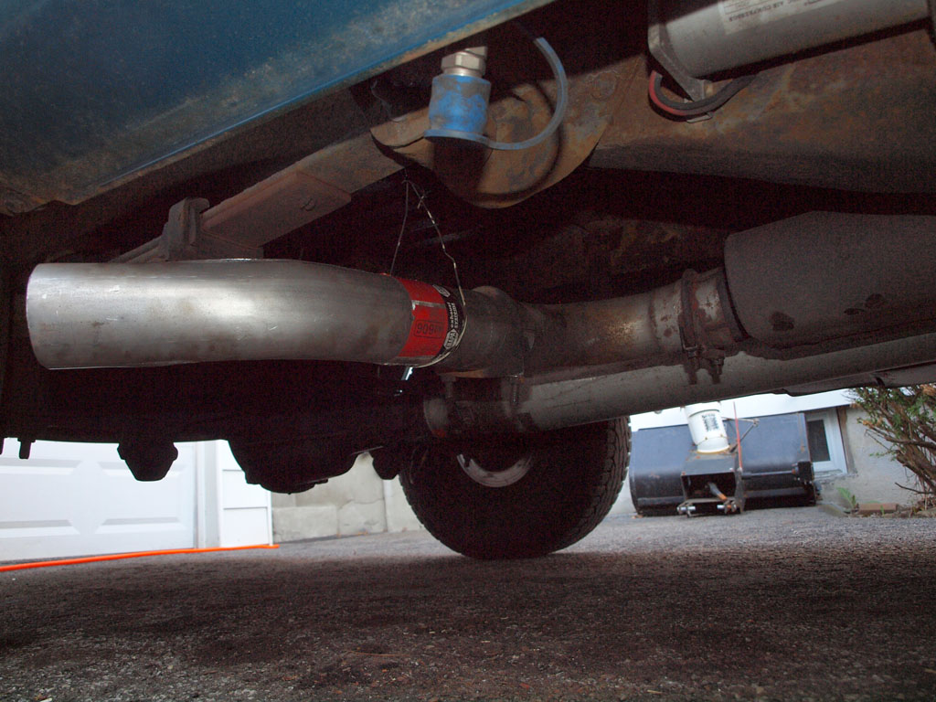

The rest of the exhaust I bolted together earlier:​

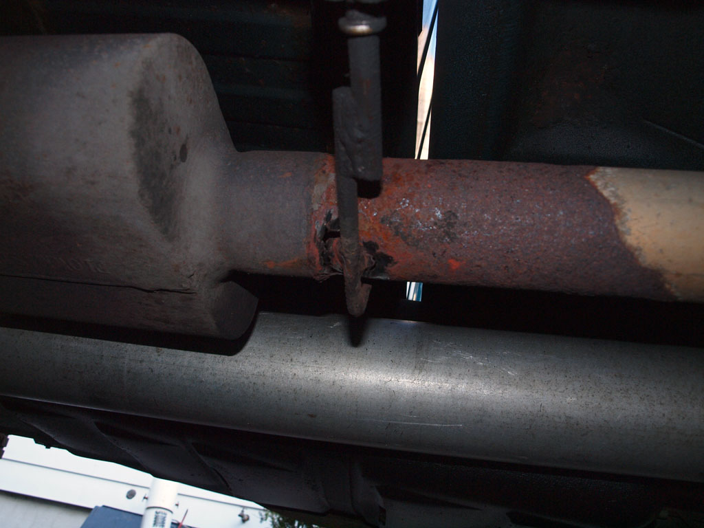

The hole by the exhaust hanger before the muffler that I'm trying to weld after I ground it down a bit:​

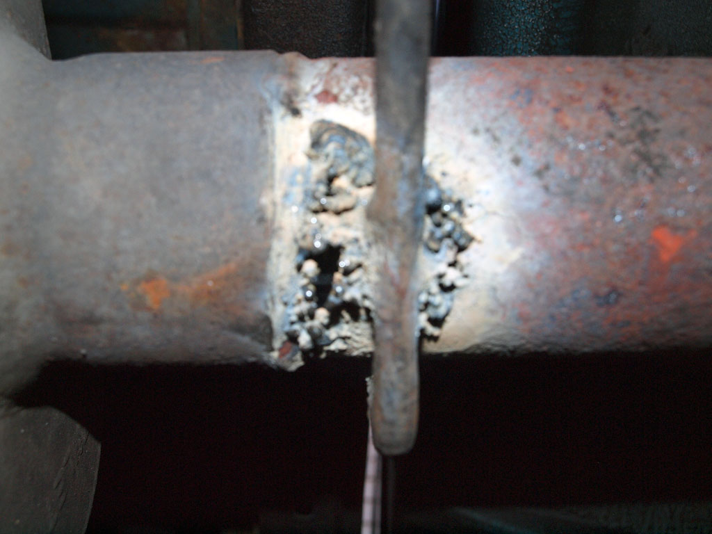

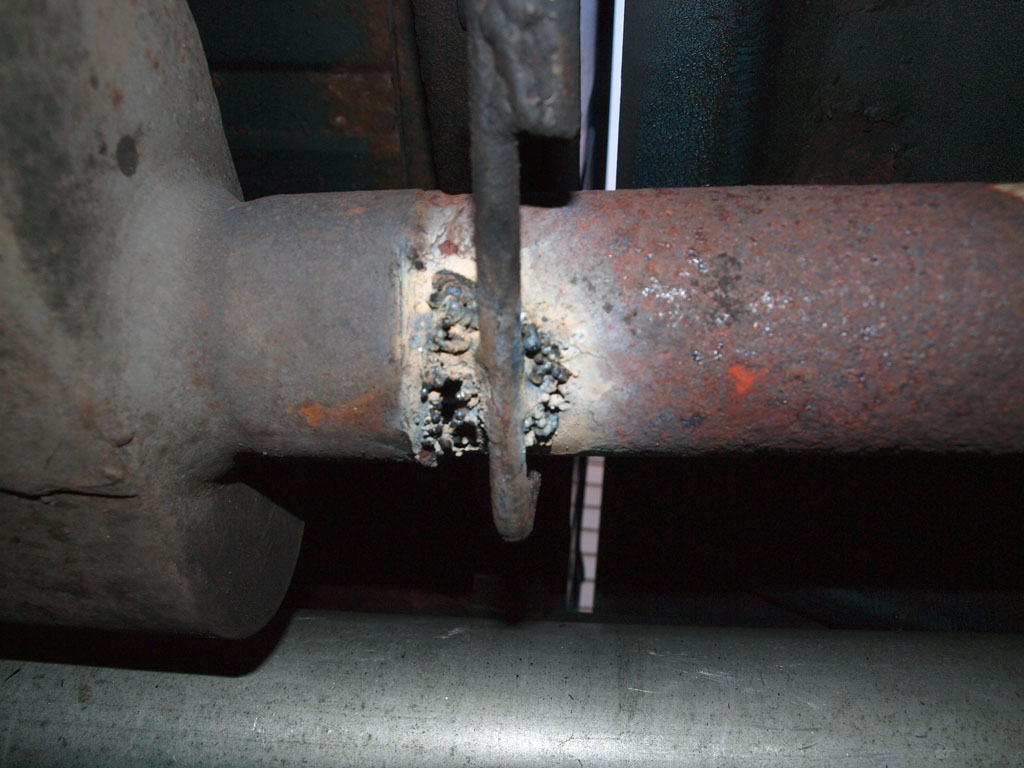

After about 15-20 minutes of attempting to weld the hole up, this was the $%&# job I was left with.​
There are still holes there and I hate this beginner "booger weld" crap job I did.​
What am I doing wrong and why is it welding like garbage?​

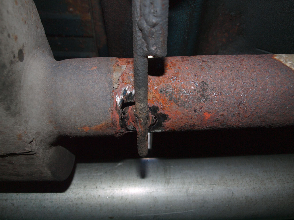

Here is a closer pic, but it is a bit out of focus since the camera didn't know what to focus in on:​

This isn't going to sound good, but here goes,
The first problem you have is the metal is almost too far gone to weld, you might be able to flame weld or braze it up. The second problem you have is the welder doesn't have a fine enough adjustment range to dial it in for what you are trying to do. The third problem is that you are trying to learn with flux core wire, Flux core doesn't perform well for beginner welders, if you could use solid core and use it with shieded gas, the weld would look a lot better. The material you are welding needs to be a lot cleaner for MIG welding, no rust or dirt to contaminate the weld.
You might want to practice on a flat surface to begin with and when you get the feel for it, try it again. You can do it, just going to take practice and patients.

Ok, here goes, agree mostly with Texas Deere.
First, you really need to go and grind the crap out of the area you intend to weld. MIG is not really good at welding rust unless you are using ER70-S6 with an Argon/CO2 mix. It needs to be super clean where you are trying to weld or you will get what they call "porosity". Little holes all through your weld bead. So make sure there is no rust whatsoever.
Secondly, you could try a patch plate. You do look to have better steel forward and art of the area you are welding currently. I think I would fore go the cleaning and weld in either a patch or a new section. Just easier.
Thirdly, yes stick is a bit better and can get through more rust and slop than a MIG with a weld rod like a 6010, but stick welding is also super good at blasting holes through things if your not careful. I personally hate MIG and would probably go for a stick weld and just patch it up. A thin 6010 rod at 1/16" set at 75 amps should about do it. If you do do it with this rod, be mindful of the shower of sparks you will get, this rod is super messy and causes a huge shower.
Fourthly, like Texas Deere said practice a few goes before trying it on the truck.

The hi/lo 1/2 switches are power settings. They adjust how hot the weld is going to be. The dial is your wire feed. Hotter the weld the higher the wire feed needs to be. The slower the less. This metal is very hard to weld. You have to basically tack weld the hole shut. The way I do it is tack a spot and while looking thru the helmet wait for the red to go away and tack again. Repeat that until the hole is filled. If you try to weld it its jus going to melt your weld and pipe away.

I am far from an expert in welding but I can't help noticin that it looks like you are trying to fill the hole with melted welding wire. In short, that aint gonna work.
Find a piece of steel as near to the same thickness as your pipe and cut yourself a patch panel that will overlap the hole by at least an inch. Clean the pipe, then clean it some more. Wrap the patch panel around the pipe so that it covers the hole and takes the shape of the pipe then clamp it in place. Make a few small tack welds to help hold it in place and then fill in the area between your tack welds with bead. Skip a few spaces between tack welds as you work your way around the patch and before you know it you will be done. It wouldn't hurt for you to make a few practice welds on the material you use as a patch to get the feel of your welder. Good luck.

OK first off, your heat is too low, you DO NOT NEED TO CLEAN THE #$%& OUT OF IT!! its flux core wire! Its made specifically for this dirty stuff.
Secondly GO SLOW its just a little 110 jobber. Once you get a decent string started you can build off of it.
Chip off the slag and run another bead ontop of the previous.
With flux core wire, (and lincoln makes THE BEST FLUXCORE) you need to weld up hill or vertical for the best results when ever possible, it gives the best penetration.
Thirdly... You cant weld what isnt there!!!! Add a patch and weld to something that can take the arc.
Set it around 5-6 and practice on a new piece of scrap pipe. Go vertical and stitch weld (side to side motion) WATCH THE MOLTEN PUDDLE!! That is what is doing all the work. Also try and keep no more than .5-.625 stick out on your wire, this is how you can control the heat of that puddle somewhat.
Practice first and foremost!!! Your out of practice, out of position, and you don't know your welder yet!! Your at great odds for struggling. Narrow up the odds and with patients you will get it.
